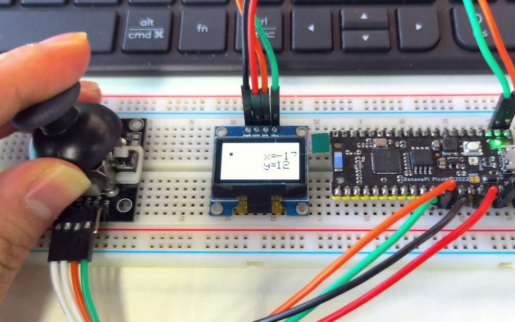

OLED实时动画显示双轴摇杆位置
基于这两章:
BPI-PicoW-S3 下载安装CircuitPython库,驱动ssd1306 oled屏幕[CircuitPython]
BPI-PicoW-S3 使用双轴摇杆[CircuitPython]
可设计一个使OLED实时动画显示双轴摇杆位置的程序。
接线参考
双轴摇杆 BPI-PicoW-S3
GND GND
+5V 3V3
VRx GP27_A1
VRy GP26_A0
ssd1306 BPI-PicoW-S3
GND GND
VCC 3V3
SCL GP0
SDA GP1

# i2c init
i2c = busio.I2C(board.GP0, board.GP1)
display = adafruit_ssd1306.SSD1306_I2C(128, 64, i2c, addr=0x3C)
# Uniformly set the color and background color of displayed characters or graphics.
# Monochrome OLEDs only need to set one and then negate the other.
display_color = 0
bg_color = not display_color
# Fill background color.
display.fill(bg_color)
display.show()
# Set 2-axis rocker pin.
x_axis_pin = analogio.AnalogIn(board.A0)
y_axis_pin = analogio.AnalogIn(board.A1)
# Calibrate the zero point.
# Take the xy-axis reading when the dual-axis joystick is at rest and set it to zero point.
display.text('Zero adjustment', 0, 20, display_color, font_name='font5x8.bin', size=1)
display.text('Do not touch', 0, 28, display_color, font_name='font5x8.bin', size=1)
display.show()
zero = get_zero(times =200, sleep = 0.01)
display.text('Do not touch', 0, 28, bg_color, font_name='font5x8.bin', size=1)
str_zero = "x={},y={}".format(zero[0],zero[1])
display.text(str_zero, 0, 28, display_color, font_name='font5x8.bin', size=1)
display.show()
print(str_zero)
time.sleep(2)
# Different hardware measures different extreme values.
display.text('Extremum adjustment', 0, 20, display_color, font_name='font5x8.bin', size=1)
display.text('Rotary rocker', 0, 28, display_color, font_name='font5x8.bin', size=1)
display.show()
(x_extremum,y_extremum) = get_extremum(times = 400, sleep = 0.01)
display.text('Extremum adjustment', 0, 20, bg_color, font_name='font5x8.bin', size=1)
display.text('Rotary rocker', 0, 28, bg_color, font_name='font5x8.bin', size=1)
str_x_extremum = "x_min={},x_max={}".format(x_extremum[0],x_extremum[1])
str_y_extremum = "y_min={},y_max={}".format(y_extremum[0],y_extremum[1])
display.text(str_x_extremum, 0, 20, display_color, font_name='font5x8.bin', size=1)
display.text(str_y_extremum, 0, 28, display_color, font_name='font5x8.bin', size=1)
print((str_x_extremum, str_y_extremum))
display.show()
time.sleep(2)
# Setting the scale spacing can eliminate unnecessary jitter.
(x_spacing,y_spacing) = get_spacing(level = 32 , zero = zero, x_extremum = x_extremum,y_extremum = y_extremum)
print((x_spacing, y_spacing))
display.text('x=', 70, 16, display_color, font_name='font5x8.bin', size=2)
display.text('y=', 70, 32, display_color, font_name='font5x8.bin', size=2)
(x_axis,y_axis) = (0,0)
(x_axis_1,y_axis_1) = (1,1)
(x_axis_2,y_axis_2) = (0,0)
display.show()
while True:
    # Get the coordinate value in a loop.
    (x_axis,y_axis) = get_coordinates(zero = zero, x_spacing = x_spacing, y_spacing = y_spacing)
    # Only refresh the display when the coordinates change.
    if (x_axis,y_axis) == (x_axis_1,y_axis_1):
        pass
    else:
        # Using background color inversion for identical pixels,
        # pixels can be refreshed with minimal performance cost.
        display.fill_rect(x_axis_2-3, y_axis_2-3, 6, 6, bg_color)
        display.text(str(x_axis_1), 90, 16, bg_color, font_name='font5x8.bin', size=2)
        display.text(str(y_axis_1), 90, 32, bg_color, font_name='font5x8.bin', size=2)
        (x_axis_1,y_axis_1) = (x_axis,y_axis)
        (x_axis_2,y_axis_2) = (x_axis+32, -y_axis+32)
        display.fill_rect(x_axis_2-3, y_axis_2-3, 6, 6, display_color)
        display.text(str(x_axis_1), 90, 16, display_color, font_name='font5x8.bin', size=2)
        display.text(str(y_axis_1), 90, 32, display_color, font_name='font5x8.bin', size=2)
        display.show()
