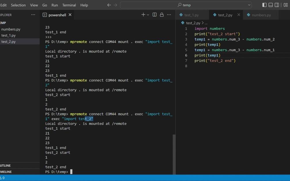

exec 运行一段python代码
mount 命令很适合与 exec 命令联合使用,装载本地文件夹后在REPL中导入其中的python脚本,输出的内容会打印在终端中。
mpremote connect COM44 mount . exec "import test_1" exec "import test_2"
运行后得到如下结果:
PS D:\temp> mpremote connect COM44 mount . exec "import test_1" exec "import test_2"
Local directory . is mounted at /remote
test_1 start
21
22
23
test_1 end
test_2 start
1
2
test_2 end
PS D:\temp>
